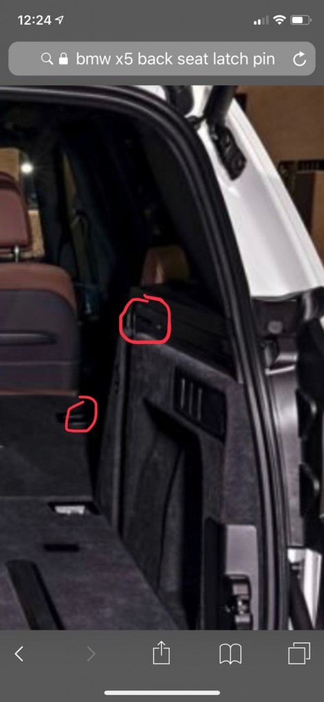

Moi j ai pas ça, mais j ai des craquements qui proviennent de l arriere j ai l Impression. Ça m énerve mais ça m énerve !!! Surtout avec le silence de l électrique je n entends que ça ! J hésite entre le toit ouvrant, la banquette ou le coffre !

Ou peut être ça ...
I had the same issue on my E70 and after so many trips to the dealership with no luck to find the root cause, I found it myself, it was the latch where the back seat locks to secure it. On either side, in my case it was the right side, I just used the black electric tape on the metal piece, and the friction was reduced to zero, no more cluck noise. It used to drive me crazy, I know the feeling!
