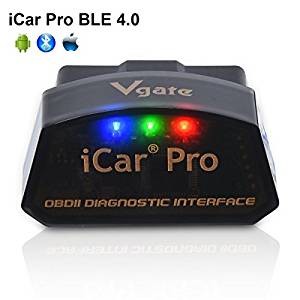

Tu as codé avec bimmer et quel adaptateur ?
Re: Black panel
salut,
Vgate ble 4.0 for iOS iPhone iPad/Android
