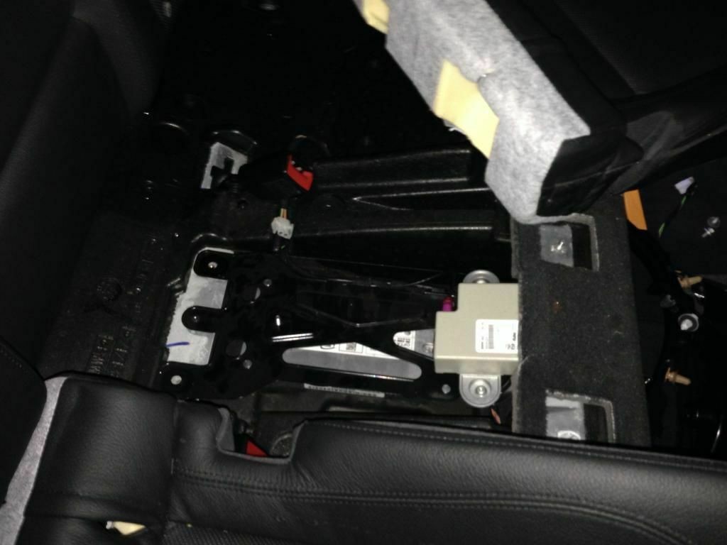

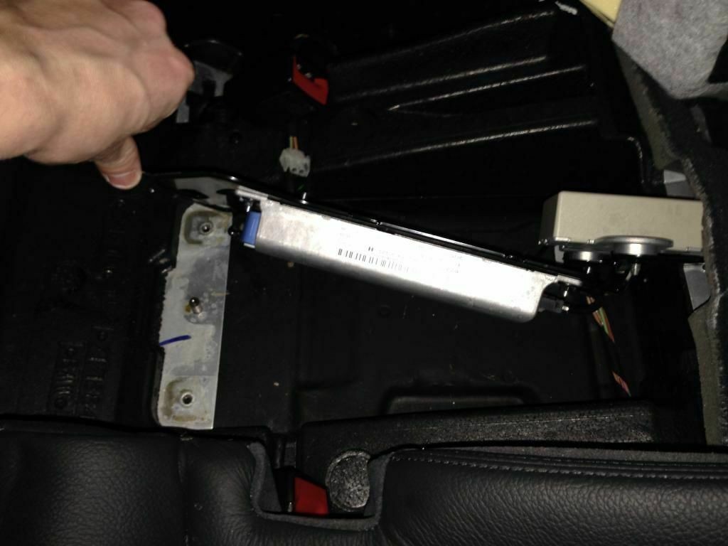

Je viens de récolter les infos suivantes directement auprès du réparateur:
thank you for the message. The unit on the back left is the TCU thats right. If you also got an MULF 2 HIgh within your car depends on if you got an USB slot. If so the MULF unit is in the middle of your back seats. ( Look at the pictures attached )
If so, please send both, TCU and MULF ! But only buy ONE Mulf repair. We check both devices and the one which is defective we repair and the other one will get a cost free Software update. :-)
